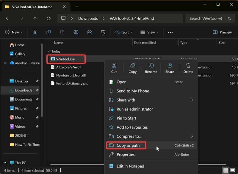

  3. Open the extracted folder, and find the ViveTool.exe file. Right-click it and select Copy as path from the context menu. You'll need it for all the following commands.

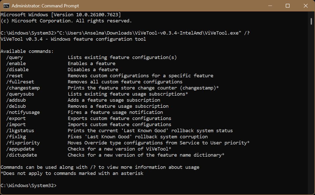

  1. Type CMD in Windows Search and click on Run as administrator.
  2. To view a list of all the available commands, type: "full path for vivetool.exe" /? and press Enter. Replace the placeholder in the quote marks with the actual file path. For example, in my case, the command looked like this: "C:\Users\Anselma\Downloads\ViVeTool-v0.3.4-IntelAmd\ViVeTool.exe" /?

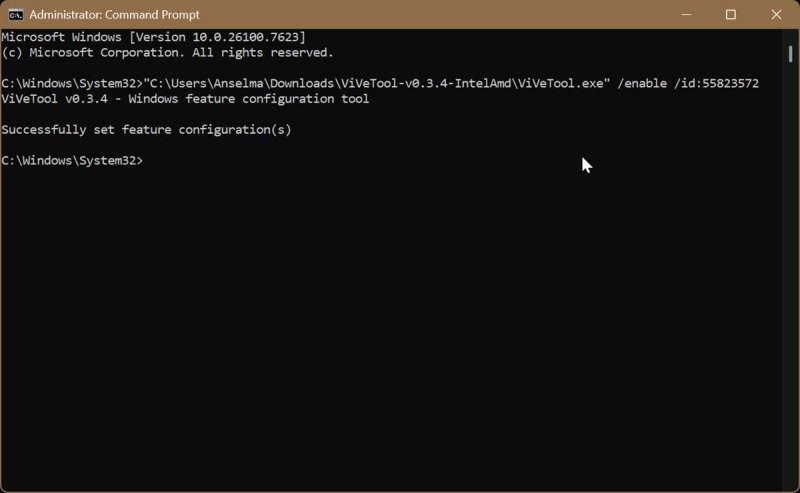

  3. If you want to enable a hidden feature, type this command: "full path for vivetool.exe" /enable /id:*feature ID* and press Enter. *feature ID* is a placeholder you should replace with the real ID number for the feature you want to enable. So, if I wanted to enable, for example, the Desktop Spotlight context menu (with the feature ID 55823572), the command should look like this: "C:\Users\Anselma\Downloads\ViVeTool-v0.3.4-IntelAmd\ViVeTool.exe" /enable /id:55823572

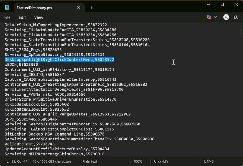

In the Feature Dictionary included in the extracted ViveTool folder. It's a PFS file you can open with Notepad. Right-click it and select Open with > Notepad. You should see a long (and frankly, confusing) list of features and number IDs.
Now, the tricky part is that the list doesn't really tell you what these features do. Some names are self-explanatory, but the majority aren't. And to make things worse, there isn't (or at least, I couldn't find one) an updated list with all the current features, IDs, and clear descriptions.
You'll have to Google them and look up what they do. I don't recommend inputting IDs blindly and just trying them out.
Also, you should only enable the features you really want to use and keep track of their IDs. They might change. You can use the /appupdate and /dictupdate commands to update the app and feature ID dictionary, respectively.
