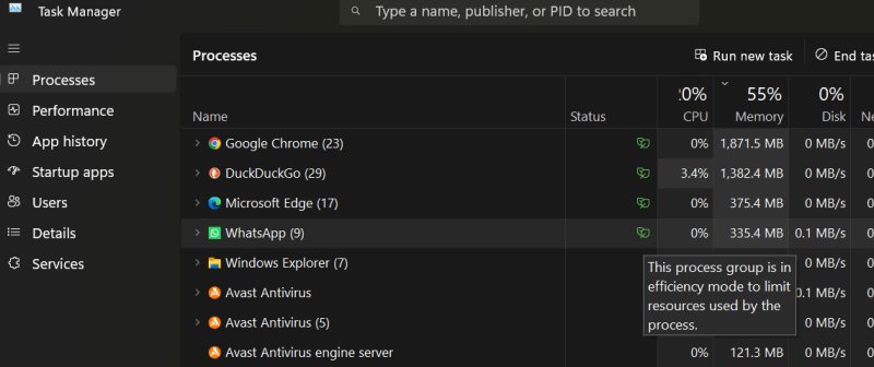

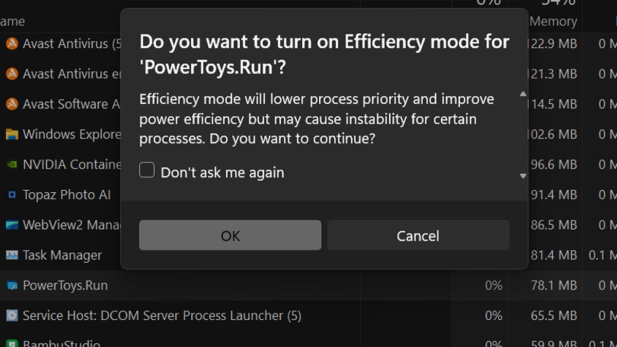

How to Enable Efficiency Mode​
Efficiency Mode does not change system files or apply permanent settings. If an app becomes slow or unstable, simply turn Efficiency Mode off for that process. Turning on (or off) Efficiency Mode takes only a few seconds:
  • Press Ctrl + Shift + Esc to open Task Manager
  • Click the Processes tab
  • Right-click the app using excessive CPU or RAM
  • Select Efficiency mode
The change happens immediately, no need to rebbot, and can be undone at any time.
Once enabled, you will see a Green Leaf icon in the status column to indicate that Efficiency is active and working. This is nice because you don't have to remember which app you enabled previously. .
