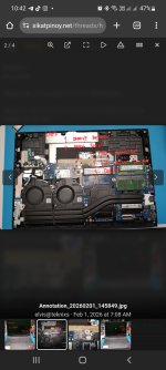

Problem
No power
Diagnosis : Corrupted PCH RTC SRAM data
Solution : Remove battery, press and hold, power btn switch for 30 sec
Then try again, power then plug in the charger and power on.
