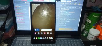

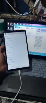

SAMSUNG TAB A9 FRP RESET VIA UNLOCK TOOL
OPERATION:
1.Hard reset mo muna yung tablet at i power off
2.In Unlock Tool select on tab model SAMSUNG TAB A9 see below!
3.HIT start HOLD BOTH Volume Down/Up and insert usb cable
4.Wait the process 100% DONE
[PRELOADER] ERASE FRP Selected auth : CUSTOM DA
Retrieving server data... OK [367.36 KiB]
Phone must have battery inside!
Waiting for device... COM4 [PRELOADER:0E8D:2000]
Handshaking... OK
Reading hardware info... OK
Hardware : MT6789 [Helio G99] 1208 8A00 CA00 0000
Security Config : SCB DAA
MEID : 3BEFF91202532B7FA697E063AC9CF9DD
Custom DA(e) : Samsung_X115_MT6789_BIT3
Sending Download-Agent... OK
Syncing with target... OK
Booting device (preloader auth)... OK
Authenticating SLA... OK
Syncing with DA... OK
Storage : UFS - CID : 4B4D355039303031444D2D423432340000000000
UFS: LU0 Size : 4 MiB - LU1 Size : 4 MiB - LU2 Size : 59.59 GiB
Reading partition info... OK [61]
Reading device info... OK [super]
Model Name : SM-X115_EUR_XX_MKEY0
Manufacturer : SAMSUNG
Build ID : X115XXS8DZA6
Connecting to device... OK
Erasing FRP... OK
UNLOCKTOOL 2026.01.20.0
Elapsed time : 20 seconds
